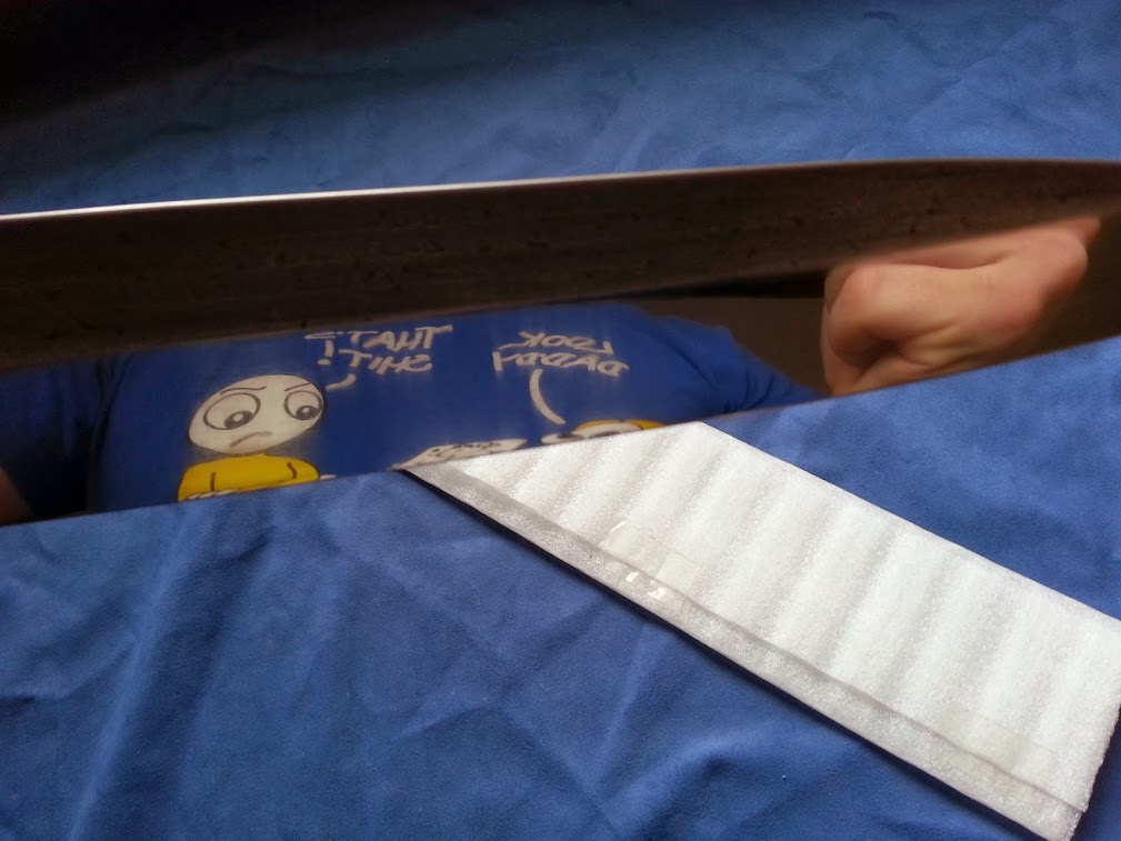

    I spent some time with Forgecraft. Mainly I thinn it a lot, etch it, polish blade road to mirror finish, make the choil bigger and rounded it as well as the spine.
    Before:
    [​IMG] #
    After:
    Before:
    After:
    I was surprised that it was so hard to mirror polish it. It is still not perfect. Steel is very soft and gets those micro scratches super fast and you can notice that even after drying it with towel:(

    Should mirror the last image to make the joke of your shirt's reflection. Looks pretty good, in my opinion. I like the texture on the initial blade but it's a real shame if it is too thick.

    Thanks guys. I thinned it all by hand. Atoma 140, JNS 300 when convexing and sanding paper. It wasn't that bad to be honest. However I had many problems with mirror polish. First of all after thinning I etched the whole blade, masked the top part and started polishing bevels. I wanted to do as much as possible on the stones but on the right side, near heel, there was low spot near ''shinogi'' which I couldn't reach. This is why I left JNS 300 finish and then sand it with sanding paper. I was doing that 3 times and results were crappy. After first time I noticed that there are some micro marks from etching. Then I sand it again and again. I will tell you one thing. I really don't know why but I couldn't make perfect mirror polish, perfect flat surface. It doesn't look good when you look at it from close distance. Also it is very soft and it is getting scratches even after proper drying with towel. Maybe it is only my imagination but this is what I noticed. Definitely not worth the work I put in.
