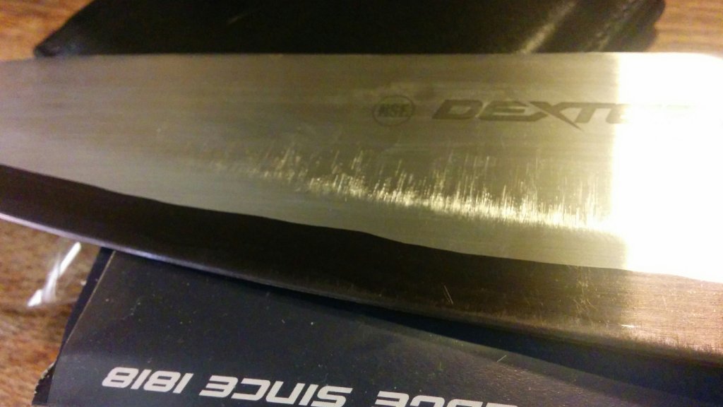

    So a while back Andre sent me a beston 500, Bester 1200, and a Suehiro Rika. But alas I was afriad to touch my new knives to them until I got the whole sharpening thing down. I play with them some on my little pocket knives but its time with the help of mrmnms and a Knife he sent me to get to the business already 2014-10-26 19.27.03.jpg

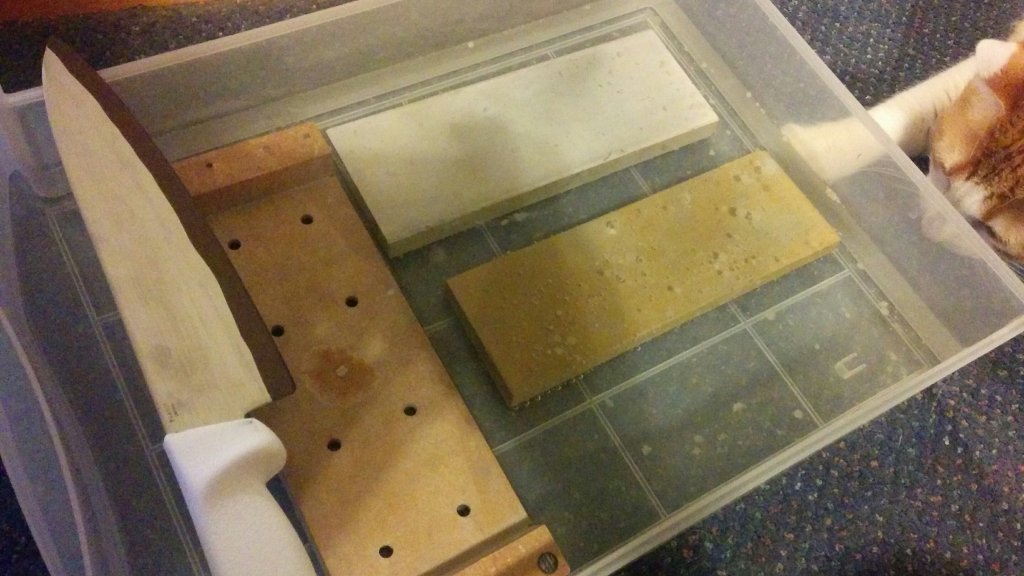

    So While the cat is keeping an eye on the soaking stones,...
    Id Like to focus on the knife, Mike marked it up for meto start with, and sharpened it as well so I know what I should have when done. I am thinking to start with I need to hit the large bevel thats half covered in sharpie until I get a bur, then do the same to other side, then repeat but at the higher angle of the blade. is that right ?
    If so any advice on ste one, the wider bevel that I will thin a bit ?

    awww,... so no thinning is needed yet (Watched some John Videos) so the sharpie is there just to see ifn im to low or high

    My advice is to keep a close eye on the cat. They will suck down water from your soaking bucket & lick the stones when they're out of the water. The worst was when mine puked on one of my stones a few weeks back. And you know how the stones will soak up liquids. :eek:

    Since you know it's sharp now, just use it a bit and then take the edge off it, maybe on the side if the 500. Then raise a burr on the 500, de burr and repeat on the 1200. I marked it so you could see where you're contacting the blade . Check where you're hitting every few passes. Shoot for just behind the edge initially and slightly raise your angle until you hit the edge. Then you'll get your burr. Other than for practice , you really dont need the Rika too much on this. The edge I left you with was from a Geshin 1200 from Jon I had just used on another knife, followed buy a few strokes on a Rika. I just figured you could practice your angles without worrying about trashing a good knife. It might not keep it long, but it takes a pretty good edge to practice. This should be a piece of cake after razors James. Have fun, you really can't mess it up much.
