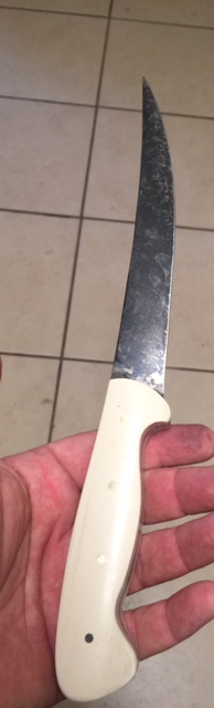

  1. I just finished this knife.
    1095 steel with corian handle and bronze pins.
    its a 12" knife approximately a 7" blade.

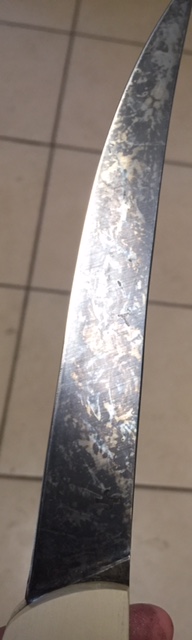

    Mustard finish on the blade.

    Looks great JJ. I'd love to hear about how it was made.
  3. Its a ground blade.
    My first boning/fillet style. So I ground it.
    The next set I will forge.
    I ground it from 3/16 piece of 1095.
    It was heat treated before beveling.
    Ground to zero edge and then machine finished.
    The handles are corian, the first time I've used it.
    I figure its great for kitchen knives since its going to imitate a counter.
    The handle is finished to320 and then buffed with scratch-less compound.
    The blade was then treated with yellow mustard until it patinas.
    Any other questions feel free.
