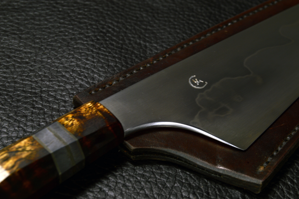

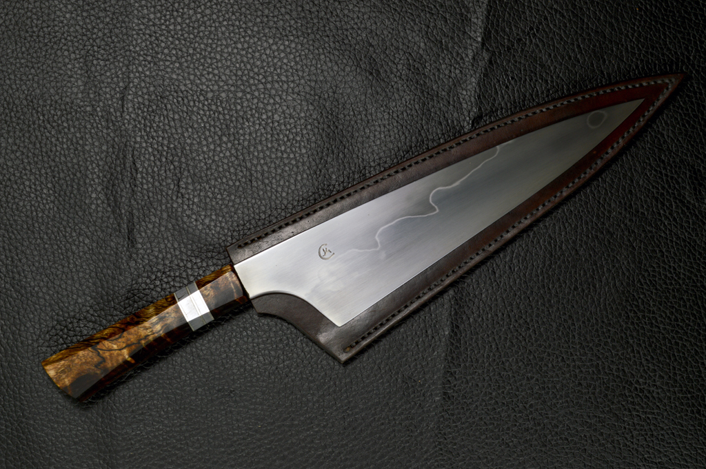

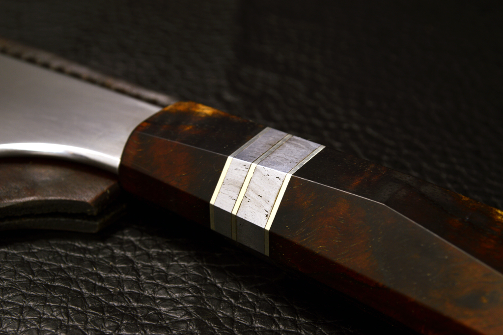

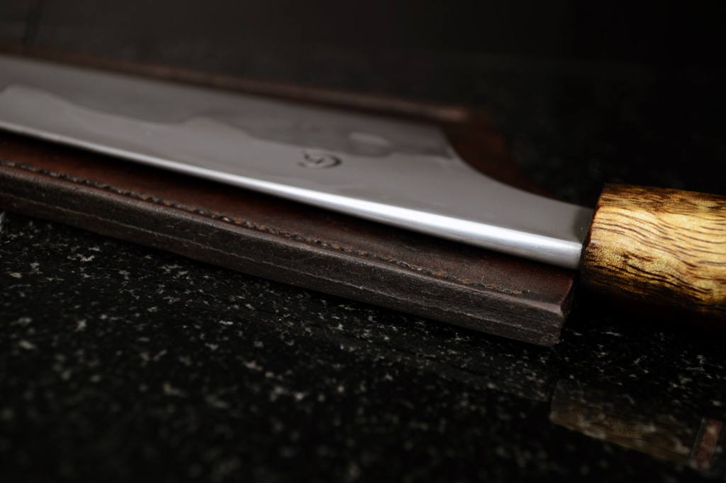

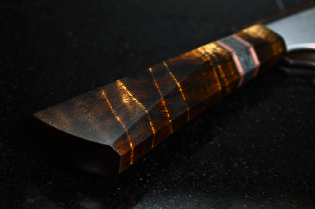

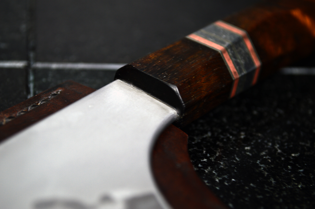

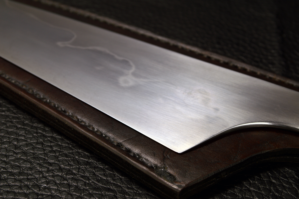

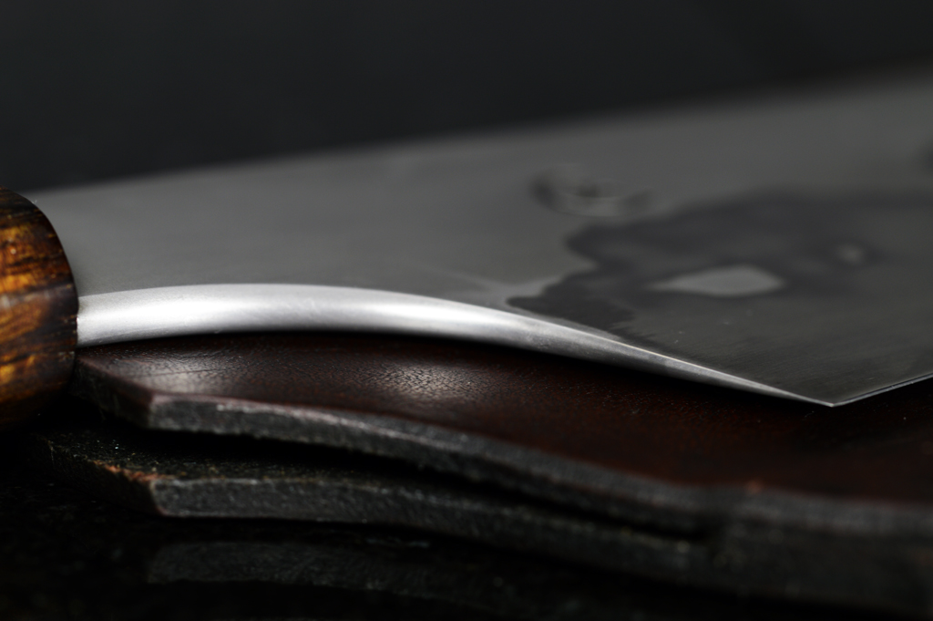

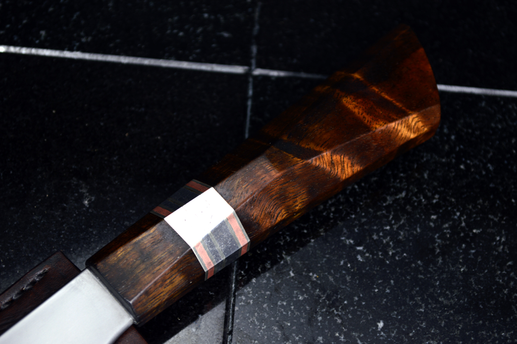

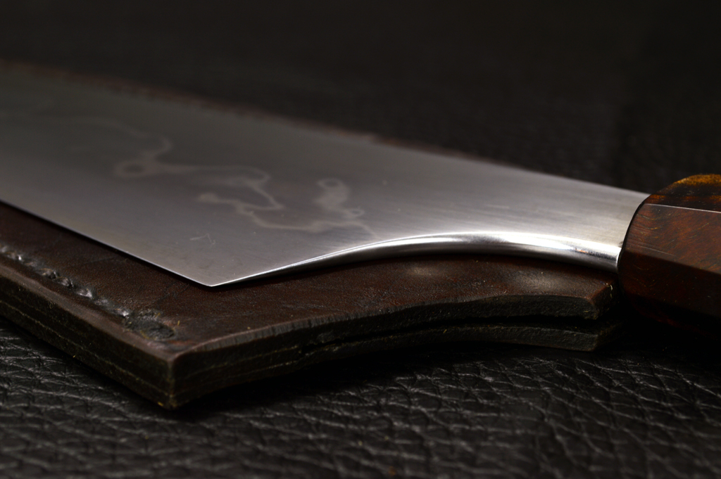

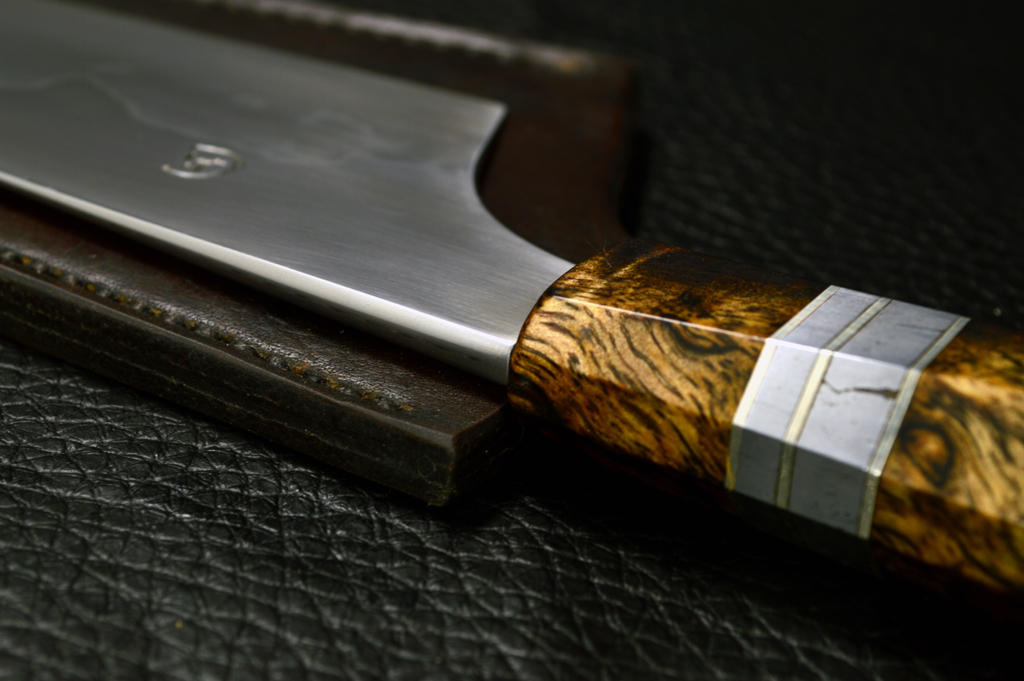

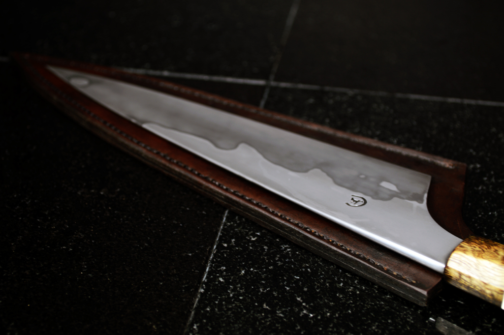

  1. This knife is the culmination of a project that has been brewing for a good while now. My customer had very particular ideas about what he wanted in some areas, and was pretty open in others. One thing he wanted was a handle that stood out, and a tall, 'heavy' blade. Now, those of you that have handled my knives know that 'heavy' isn't really in it. They are precision, lightweight, nimble cutters with an aggressive attitude built on speed. This project however has given some options to all of that. This knife weighs 176g, which in comparison to my standard 200mm gyuto weight of around 125-130g...is a pretty substantial difference. Balance is only a bit forward of the heel (due to the wrought iron spacers in the handle), but the overall feel is positively meaty. The spine is over 4mm at the ferrule, and tapers gently to just in front of where your pinch grip would end. From there, it's all my 'typical' laser, which is designed to combine great food release with extreme ease of cutting. I think we hit the nail on the head.
    All in all, this has been a really enjoyable project!
    201mm x 54mm x 4mm thick over the heel.
    Handle - Stabilized (Petes Kustom Koa) spalted 'deep compression' Hawaiian koa, with nickel silver and 165yr old wrought iron spacers.
    Many of these pictures are very similar to each other, but most show a slightly different facet of the similar view that I felt was important to get a real feel for the knife. This one is one of my favorites yet.

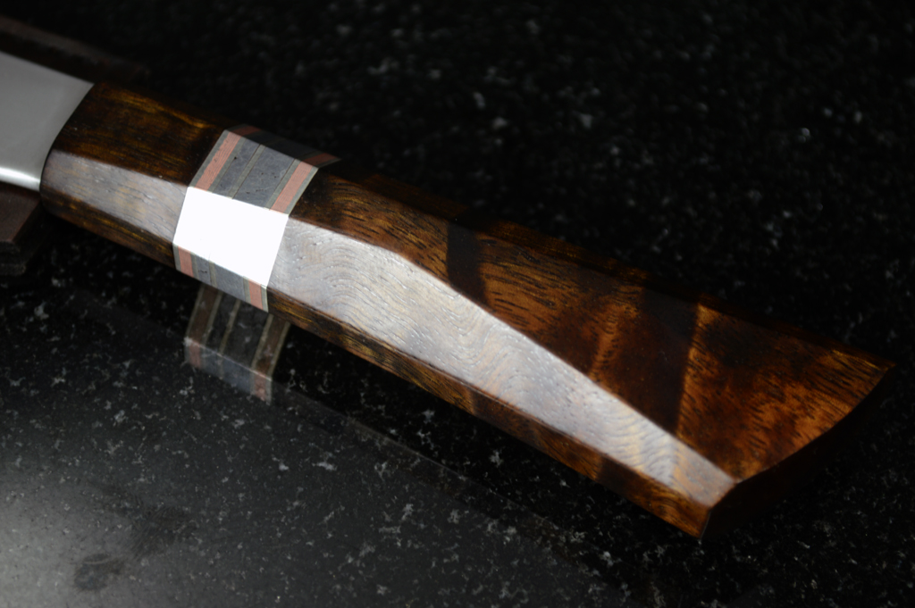

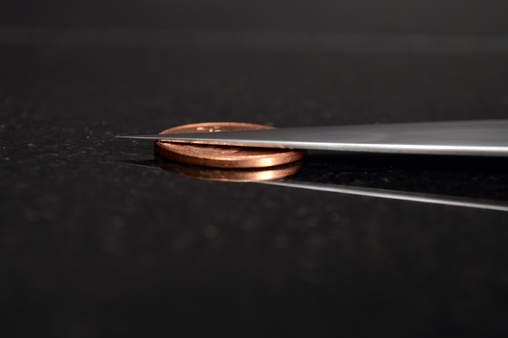

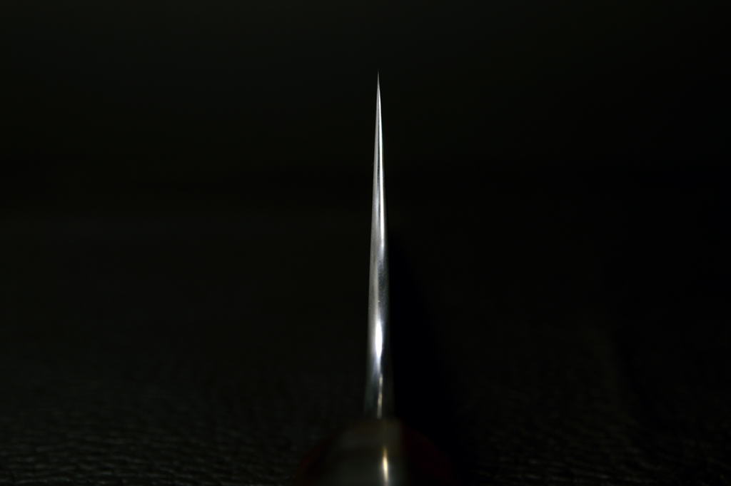

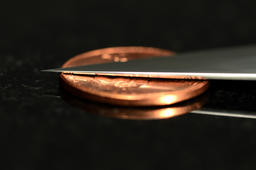

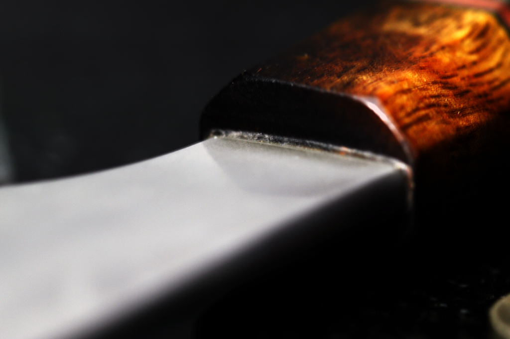

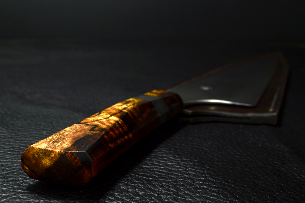

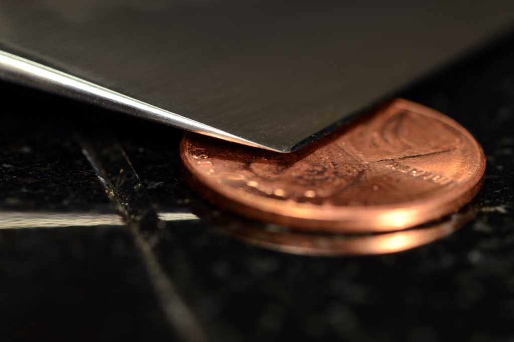

    Anyhow, Ferry asked me to snap a few more pictures of the tip (ala Robert's pictures with a coin for scale), and one of the handle from the top to show the contours...so I thought I'd share them here as well. I also threw in one of the choil for the sake of it :D.
    This is my first successful use of @WarrenB's Tamron 90mm macro lens...which I used for two of the four pictures :D. Lovely lens to work with, once you understand the limitations of a macro lens lol.
    Anyhow, on to the pictures!!
    For those of you who don't know, the coin is a US $.01 piece. The rim is 1.3mm in thickness, and the coin is 19mm in diameter.

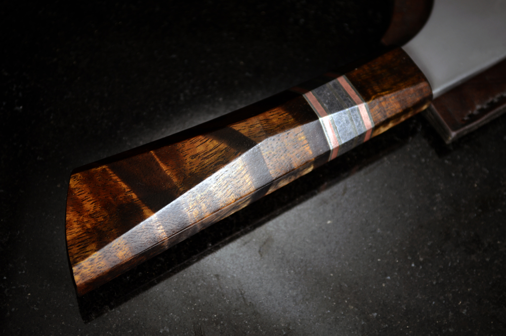

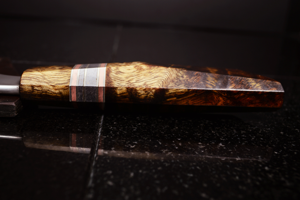

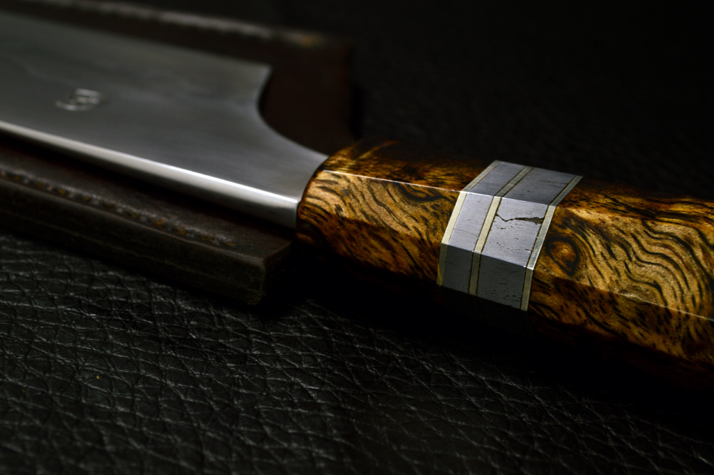

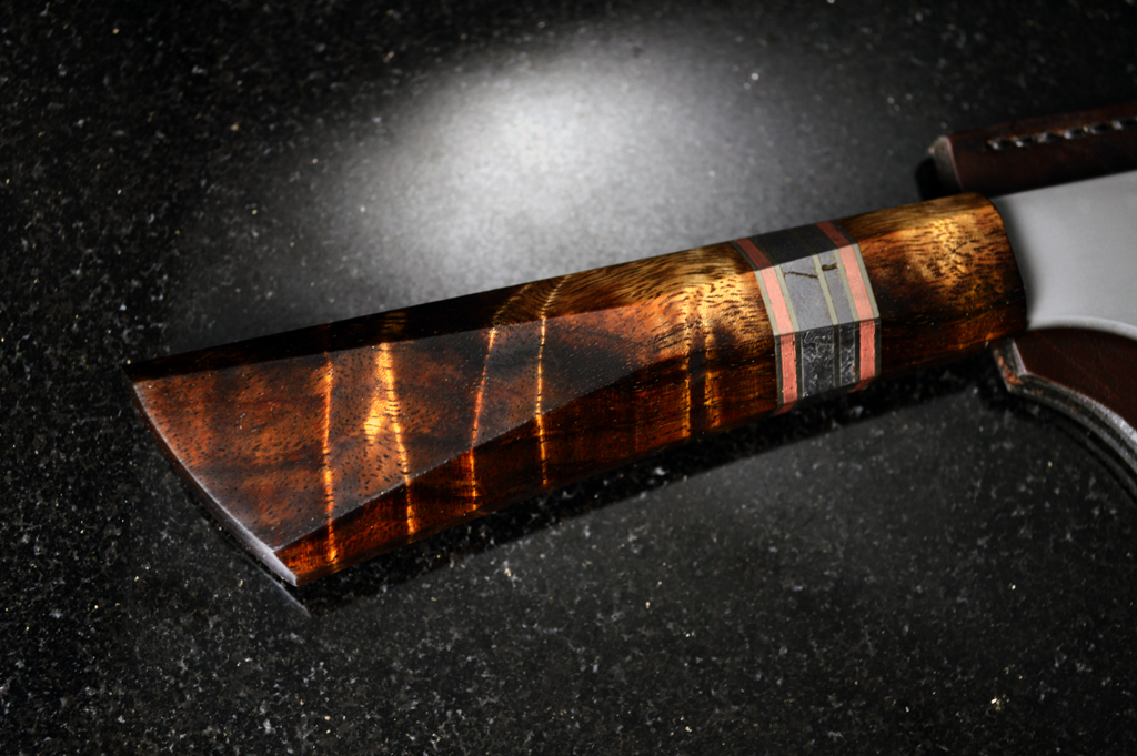

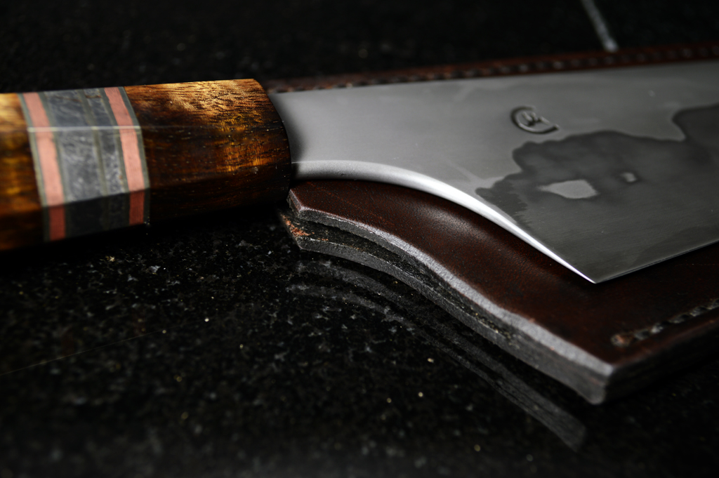

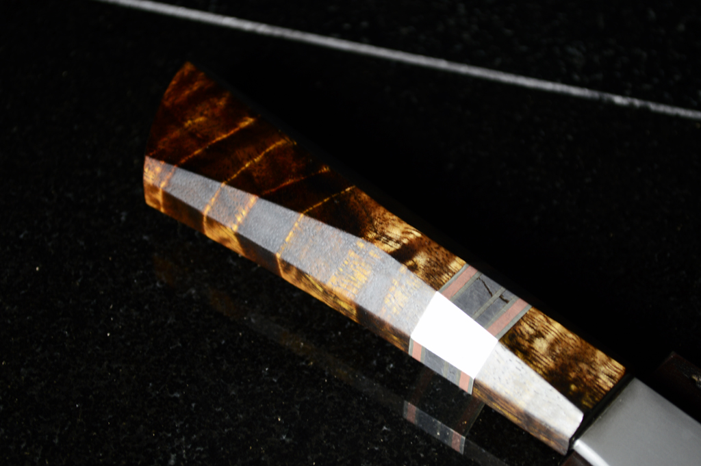

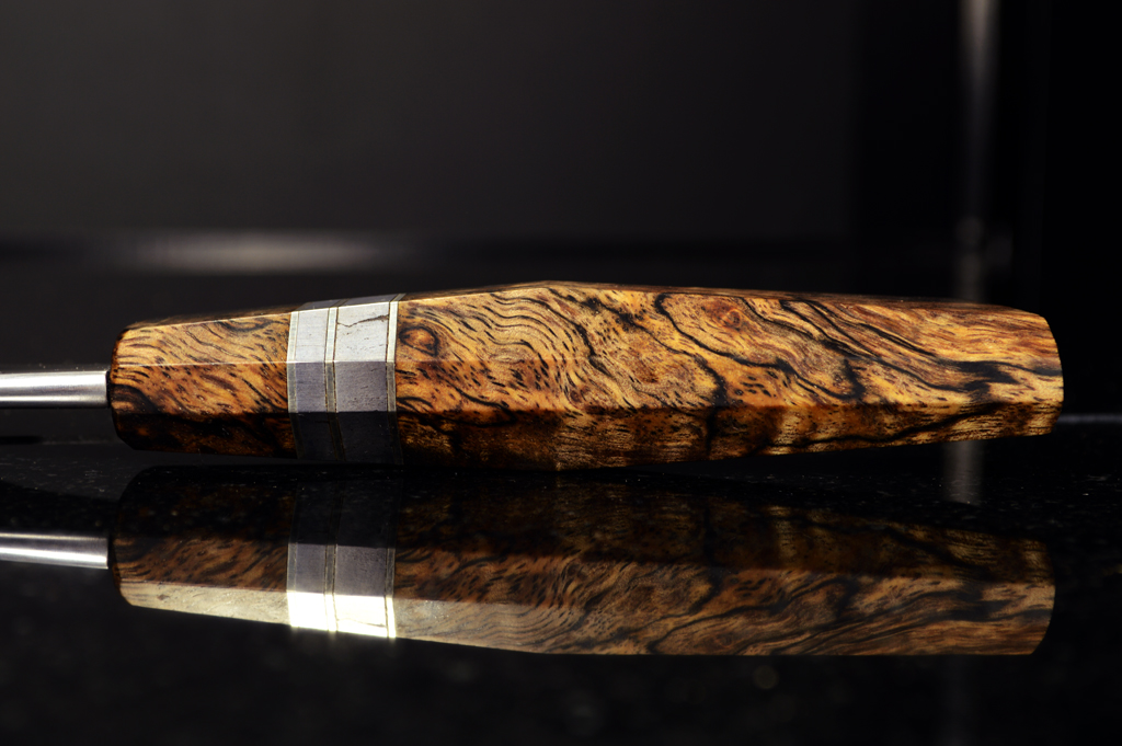

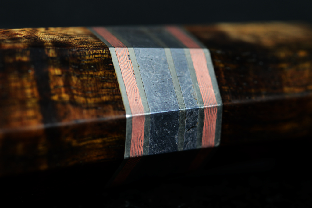

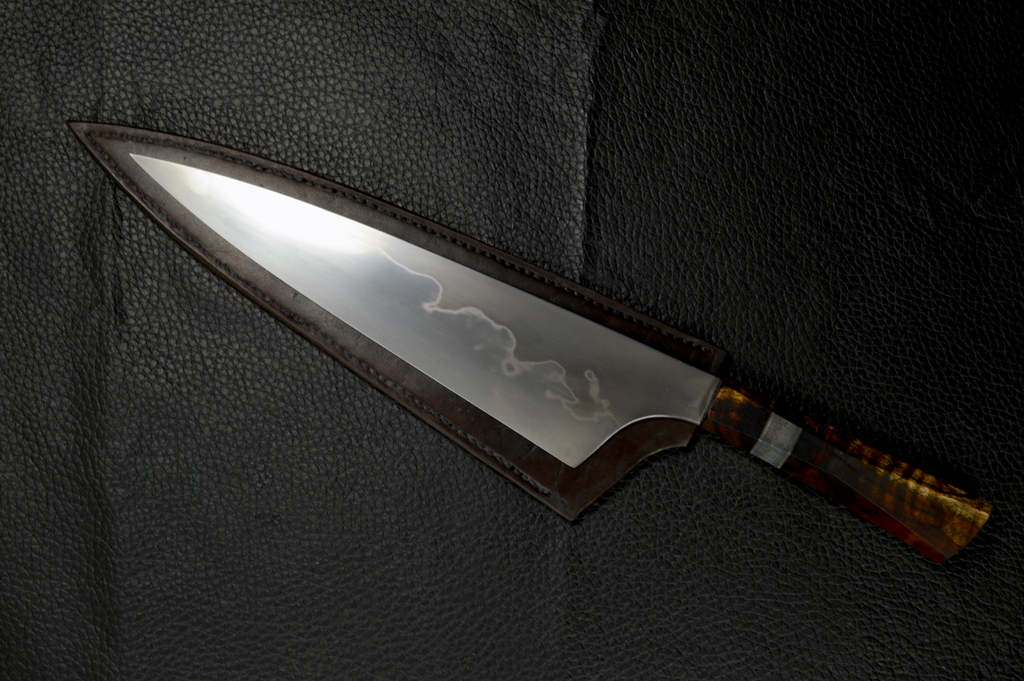

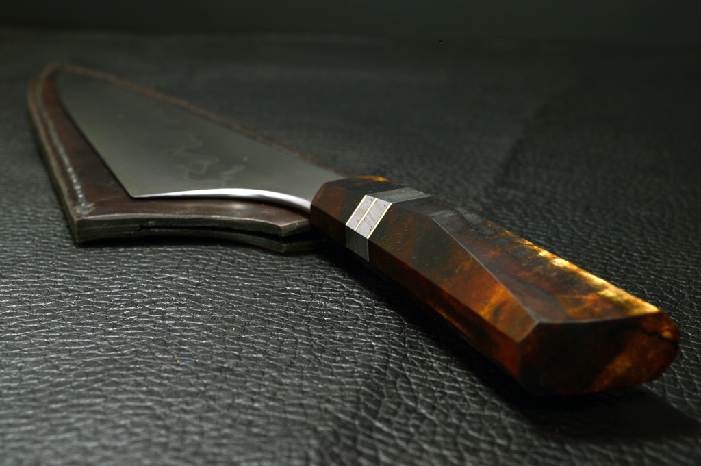

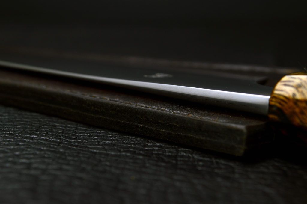

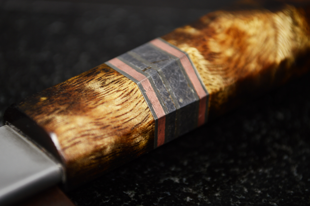

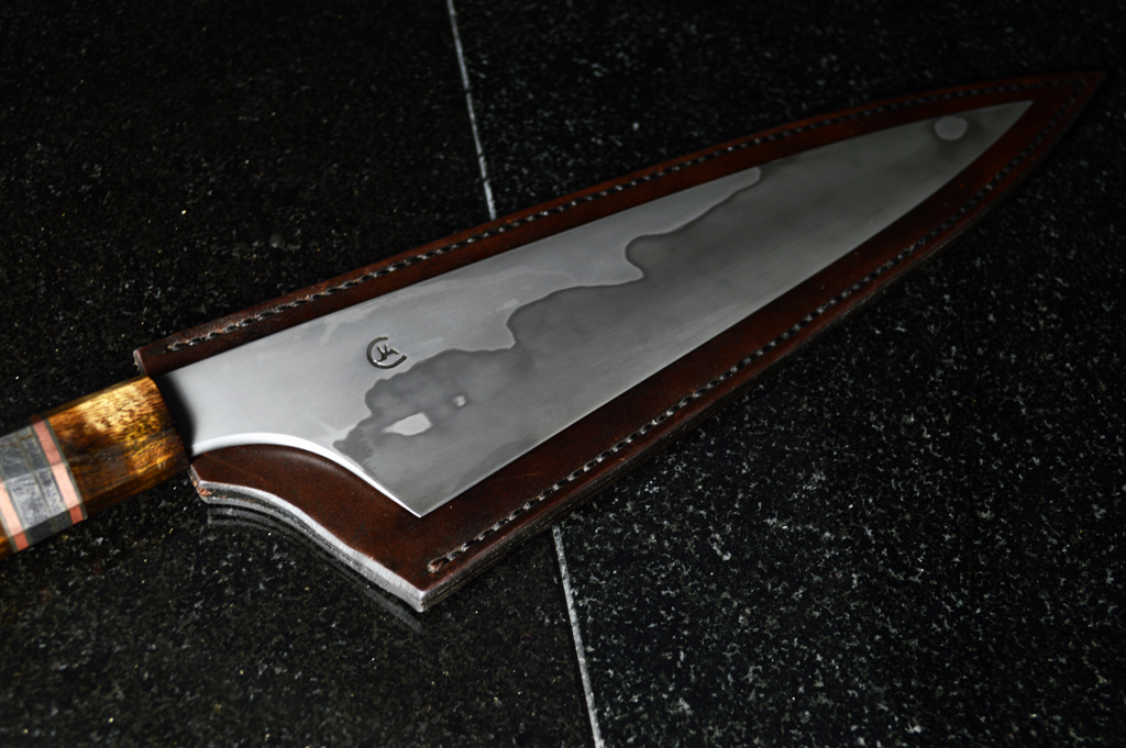

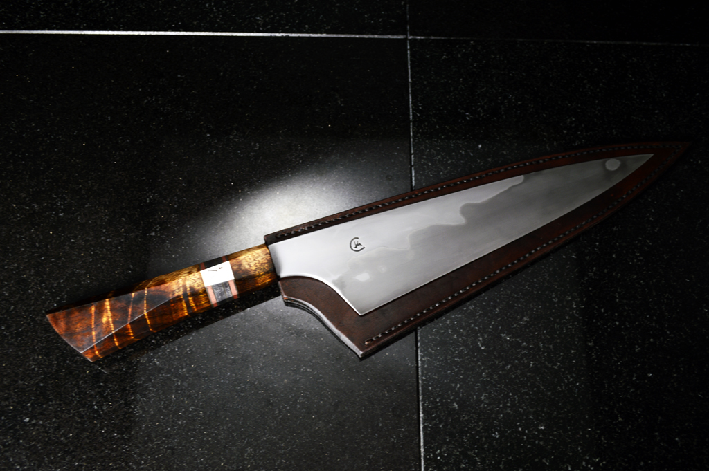

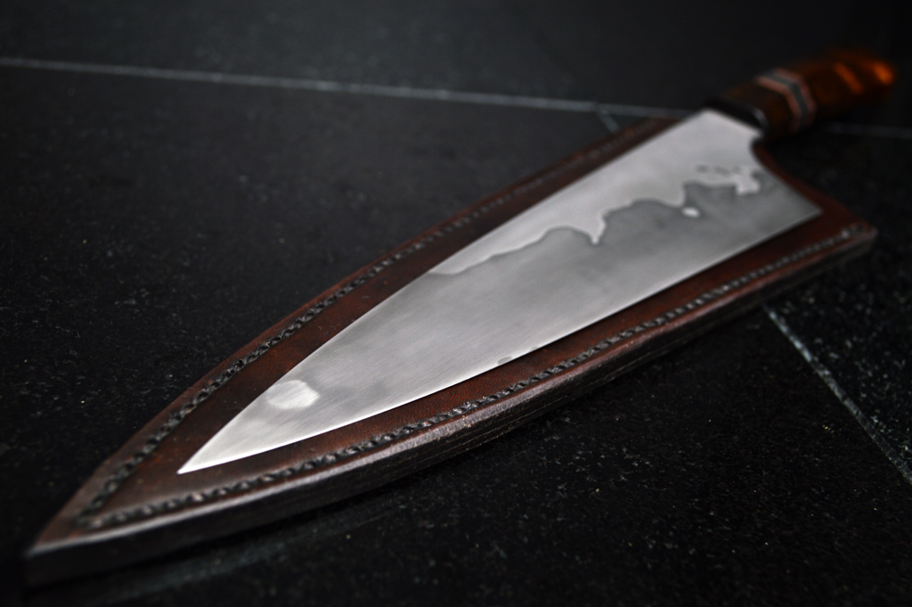

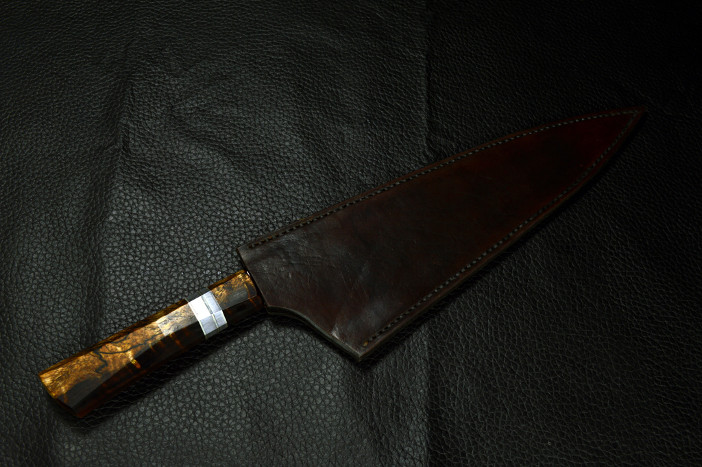

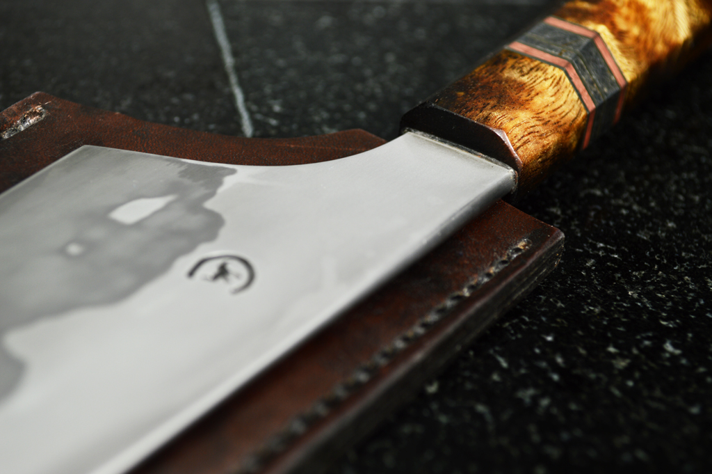

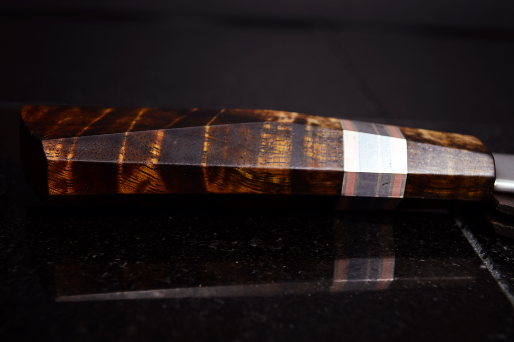

  15. So, as some of you may know, Ferry's original handle as pictured above had some...issues. The glue that I'd been using was three years old, and the heat from the double wrought iron spacer just cooked it into virtually nothing. Added to that, mounting the handle melted beeswax into all the gaps in the glue surfaces that were created from the burned out glue. When making an adjustment to the blade's position in the mount, the glue gave and the ferrule and one of the spacers popped off. I cleaned the surfaces as best as I could, and reglued. A quick grind session to regrind the lines of the handle, and I went to remount the blade. Well, it separated again. FOUR separate times it wouldn't hold. I'm assuming I was unable to remove all the wax, and it just continued to act as a release agent. It's probably for the best, as I'm sure the other joints are marginal...and I am EXTREMELY thankful that it happened in MY possession, rather than making it all the way to Australia and coming apart in Ferry's possession.
    That said, I truly feel that the replacement handle was the one always meant to be on the blade. You'll have to let me know if you agree.
    The wood is deep compression Hawaiian koa from Pete Rushton at Pete's Kustom Koa. Spacers are 165yr old wrought iron, nickel silver, and fine layered copper/nickel mokume.
    DSC_5487s.jpg DSC_5493s.jpg DSC_5500s.jpg DSC_5505s.jpg DSC_5506s.jpg DSC_5508s.jpg DSC_5513s.jpg DSC_5520s.jpg DSC_5523s.jpg DSC_5527s.jpg DSC_5529s.jpg DSC_5531s.jpg DSC_5532s.jpg DSC_5536s.jpg DSC_5545s.jpg DSC_5546s.jpg DSC_5551s.jpg DSC_5558s.jpg DSC_5559s.jpg DSC_5595s.jpg DSC_5589s.jpg DSC_55731s.jpg

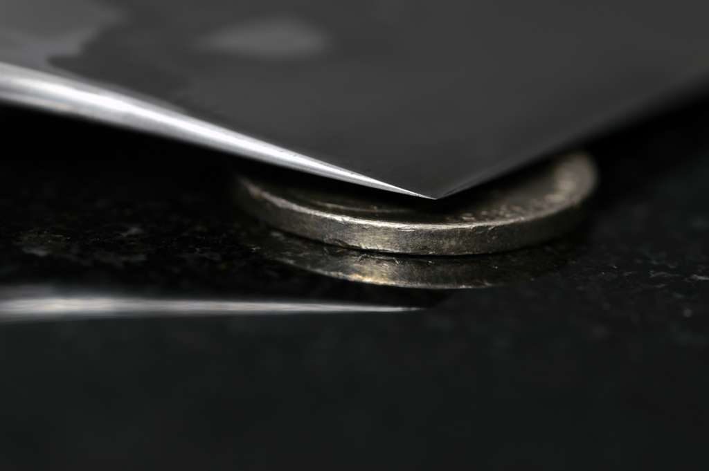

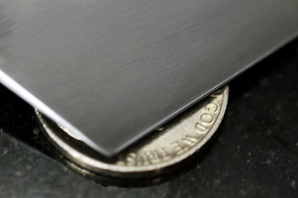

    The coin in the last two images is a US $.05 piece. Thickness is 1.87mm at the rim.
    The knife is FINALLY heading off to Ferry tomorrow. Can't wait to hear his thoughts on it!

  16. Wow, that's an incredible knife with an incredible tip. And a very interesting distal taper. And... love the handle!
