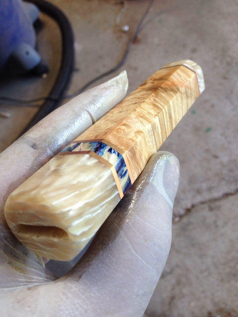

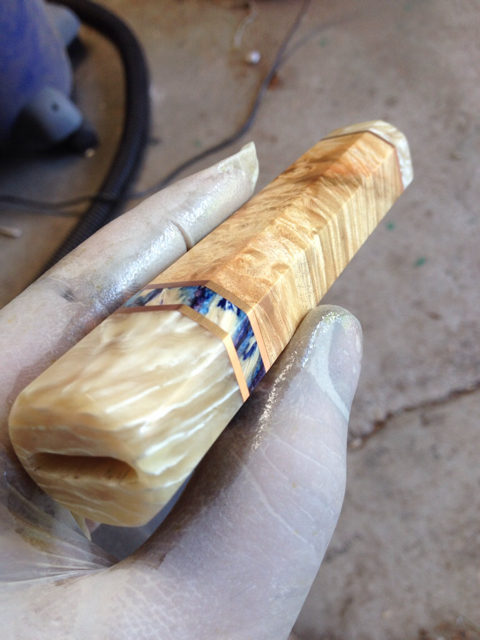

    Here is couple I made , first Meiji style d
  9. chefcomesback

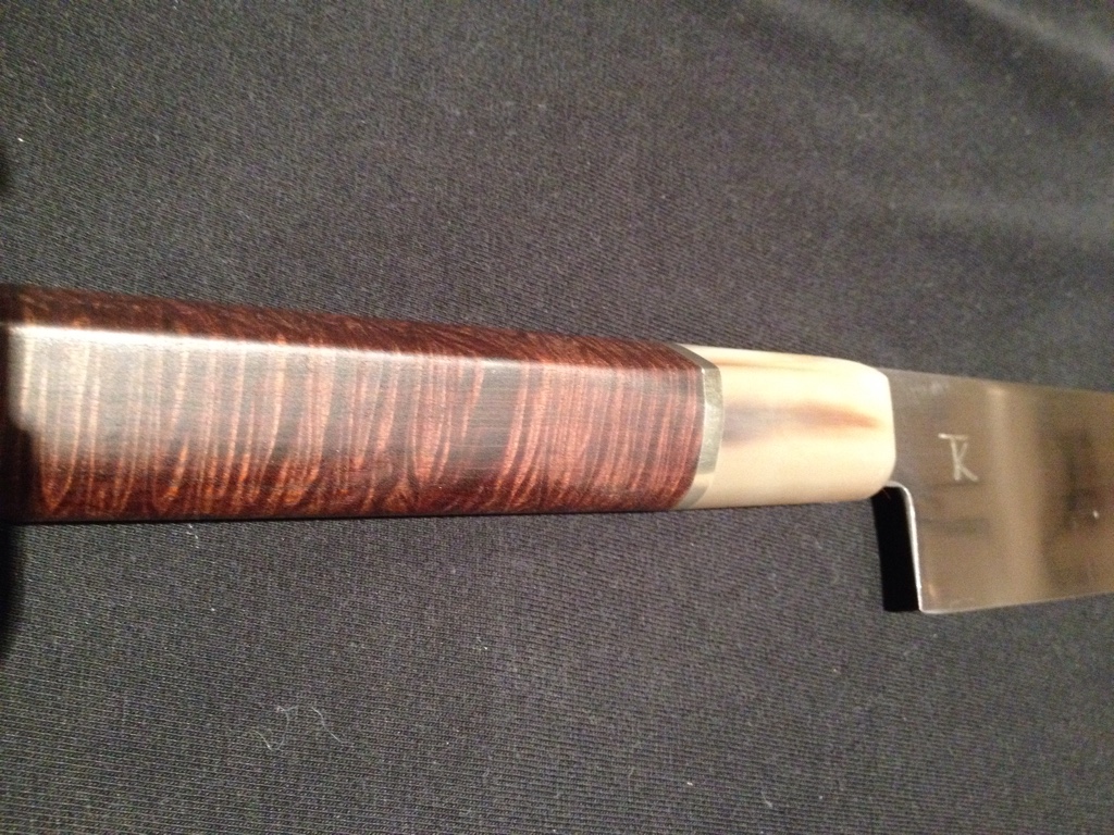

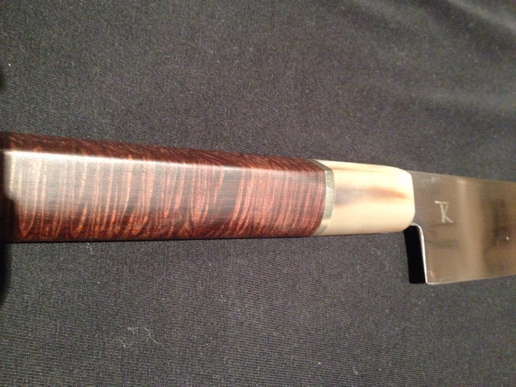

  10. chefcomesback
    Second one is an octagonal

    Finer words have ne'er been spoken. ;) But this is very much down to preference. All respect due to my friend, M.Tansu's craftwork above, too.
    Mert - love the shape on the first handle above and nice wood. Absolutely hate spacers though! Nice material on the spacer there, though
