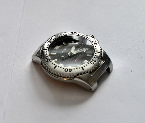

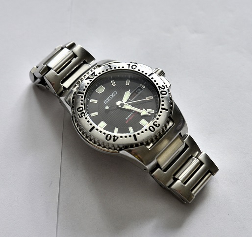

    Here is the watch with the scratched crystal

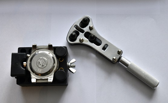

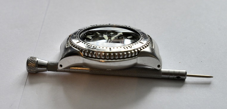

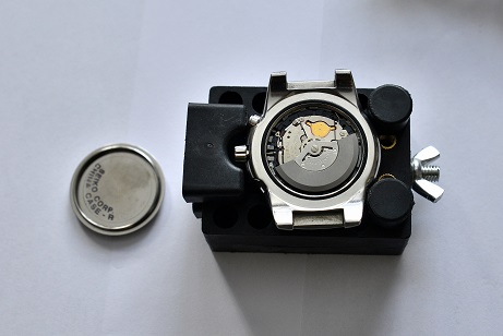

    First I removed the bracelet and clamped the body in a small watch vise to make it easier to remove the back with the case tool I already had
    Plenty of downward pressure to prevent the tool slipping and the case back unscrewed fine

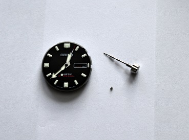

    One small screw and a small part to lift slightly and the crown and stem can be removed
    Then the movement just pops out

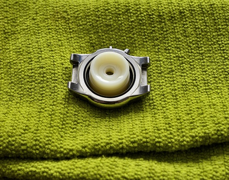

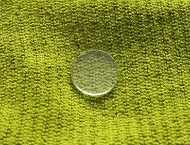

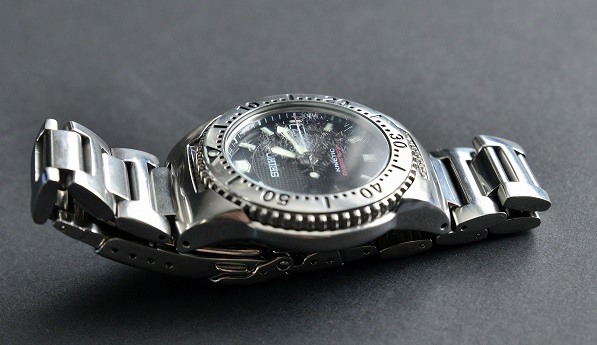

    Now the slightly more stressful part, tapping out the old crystal!! I selected one of the dies that came with the press and laid the watch on towel to let the crystal pop out and gave the die a good tap with a hammer.
    Lifted the case and there was the crystal, phewww!!

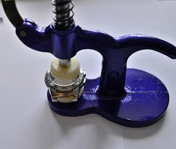

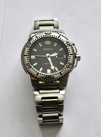

    Fitted the new gasket and crystal and then in to the press with the correct dies chosen. Squeezed the press down while pulling funny faces waiting for a pop of shattered glass!!
    And...... success:jump
    Couple more pics as I am so happy it worked out ok:)
    I can't help trying to fix stuff myself and definitely happy I gave it a go:)

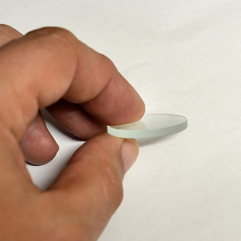

    I wasn't expecting the crystal to be so thick, approx 3mm at the edge and must be 3.5mm at the domed centre!

    Is that a screw down crown? Always worried after a going through like that that it is still water tight. assembling empty and submerging I think was the old drill, but each time you open the case, you don't know for sure when you put it back if it is still intact.

  7. Yep screw down crown Mike, well it used to be as it was faulty when I bought the watch, looks like the thread on the tube is stripped, next job on my list!
    There is a gasket in the tube that the stem goes through that makes it watertight, I actually submerged it with just the crown in and no movement fitted, the barrel I put it in was only about 4 feet deep so no real pressure but enough to see if it's safe doing the washing up with it on:D
