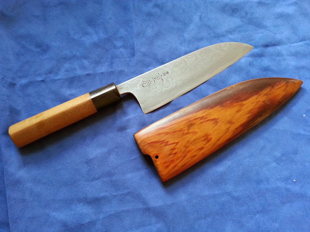

    I've made three cedar sayas from cedar I got from Bo on previous JNS gathering. They turned out very well. This cedar was very soft and comfortable to work but you could make a deep scratch or mark with your finger nail.
    Now I bought almost 8m of cedar boards, 3cm thick and it is much different. It is way harder than cedar from pictures above. I will be doing three sayas later this week so I can give you update in a few days how it goes.

  12. BathonUk
    BathonUk Founding Member
    I think that blade entrance can be tight. It won't scratch your blade if it will be smooth. It shouldn't be a problem if you have proper chisels but if you don't then you can polish that part of saya with sand paper and be sure to vacuum all dust before you glue it together. Dust can scratch your blades. I didn't find my cedars to be splintery and as I said before I got cedar from two sources. One was so soft that you could easily make a very deep mark with your finger nail. Another one is on harder side.
