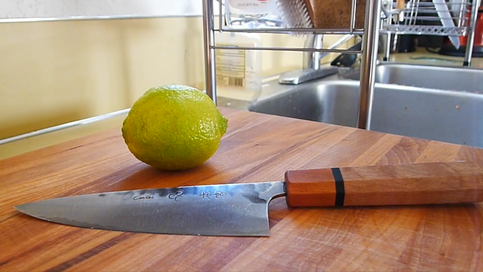

  1. Changing a short Murray Carter chef's knife into a funayuki (?), from beginning to end, with all the boring bits removed! I'm not a professional, and I thought other beginners might like to see the whole process as they might want to do it. Lots of commentary for those interested, lots of links to guide you to the bits you may want to watch.
    Problem: I have a small chef knife that doesn't cut all the way through vegetables, and isn't long enough to rock-chop well. I want to use it for board-work, so I need a flatter profile. It's not a cheap knife, so it's worth the time investment for me.
    Solution: Re-grind the knife profile for a flatter edge so that it's more effective for board-work and chopping. Process: Using only stones, we'll get the whole process done from re-grinding, thinning the blade and restoring the old convex grind so that it continues to cut well and look great.

  2. When you started to re-profile it, the thought that instantly jumped into my head was "He's not going to get very far with that file." :D
    I think you did a great job with the tools at your disposal. You are correct, for a tool to be worth it's existence, it needs to do what we need them to do.
    Personally, I like the adjustment you made, and would have probably done the same thing myself.
  3. Thanks for the feedback! Since I've used files to round spines and choils, I thought it was the way to go. Boy was I mistaken!
    I think it's nice to show when things go wrong as well as when they go right. It's helped me see others mistakes over the years so I know how to avoid them myself.
