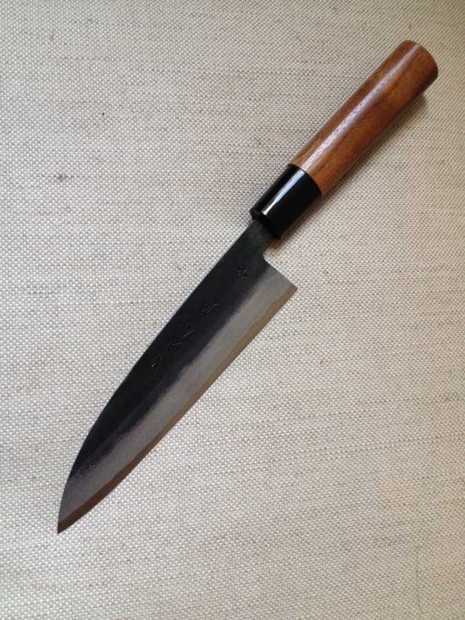

    Here it is, excuse my sh#tty bevels, as mentioned I wasn't at all concerned with making this knife look purdy, it's destined for abuse and maybe a shade of neglect.
    This knife has a nice flat profile and is fairly thick with no flex.

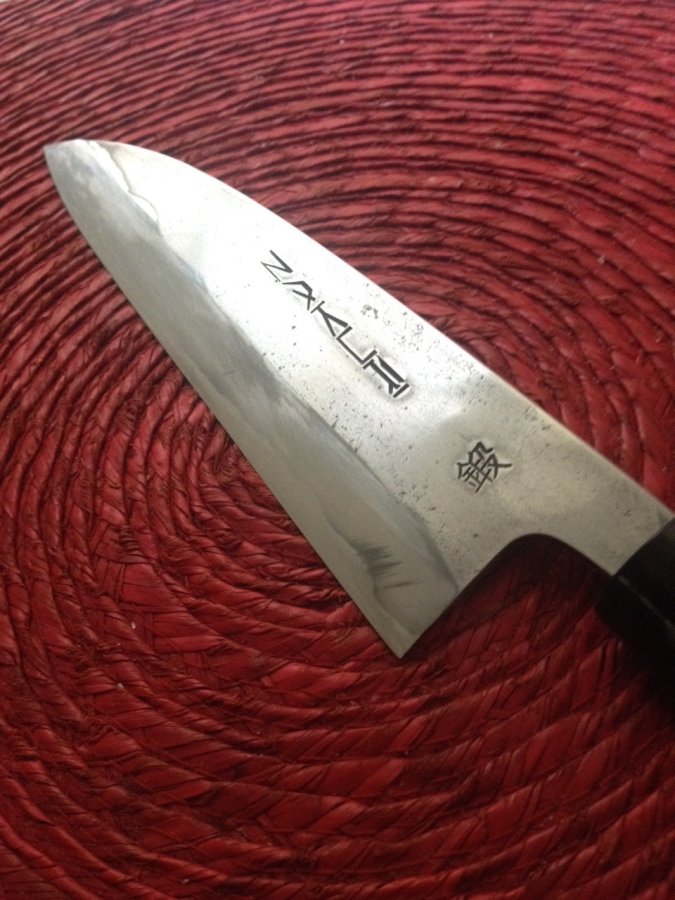

    I have mine in a slightly better polish now, but this is what it looked like while I was experimenting with a few abrasives:

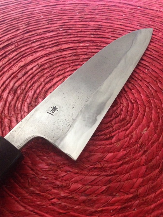

    Now my core is a bit more mirrorish and the cladding is somewhere between mist and semi-mirror. Works well and is very smooth without the draggy feeling of a standard kasumi finish, and a hell of a lot better than stock Zakuri finish:
    But to be honest, though the finish off the stones you used isn't the super sexiest, it ought to cut perfectly well. Good work and thanks for sharing...it's nice to not be the only one reworking some of these knives.

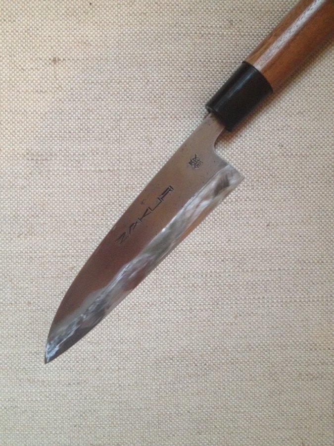

  6. So after publicly shaming myself I took the knife back to the stones. It isn't much prettier but the bevels are in better shape. Sorry for the total crap iPhone photos guys, my knife budget doesn't allow for a camera hobby. IMG_7153.JPG IMG_7154.JPG
    Cheers
    Matteo
  7. MattS
    Maybe just the camera angle, but it looks like a pretty good sized divet in the edge from the middle to the back third.
  8. no it's indeed there, came like that. not going to be used much on the board so not a huge issue.
  9. XooMG
    Hira texture is actually a bit charming.
    Those scratches by the heel really bothered me when I found them on my mini-nakiri, but they don't bother me much now and help me justify not giving that knife as much attention to finishing as I do with the funayuki.
    Shame about the frown, but it doesn't look too troublesome. My Asai and Fujiwara Teruyasu and a few others had much worse dips, but they're always annoying to me.
    Mark76: I don't remember precisely which combination, but I believe that one was soft 800 stone and maybe the JNS artificial red aoto, followed by 3m sanding sponges in superfine and microfine. Works a charm but I eventually revised it to get some more unnecessary shine from the core steel.
