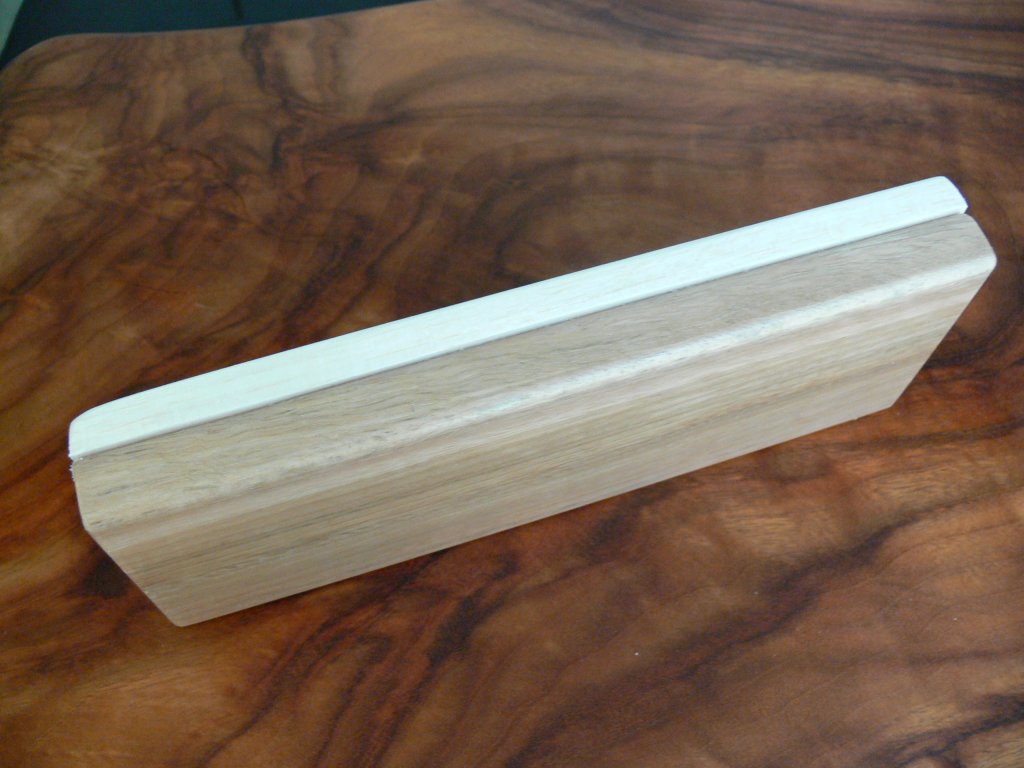

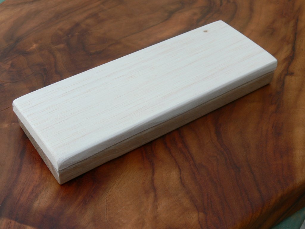

  1. Hi all, just wanted to share my homemade stropping block. Made from bits and pieces in the garage.
    I've made two, for trial and error. Will load one with micron paste the other with chromium oxide.
    Interested to hear your experiences and results have been between the two pastes/compounds and if you have found something better.
    Approx. 240mm x 80mm x 12mm
    Real measurements 9 1/2inch x 3 1/4in x 1/2in ;)
    Base block is Australian spotted gum, roughly 19mm thick.
    Made it so it will sit in the stone holder.
