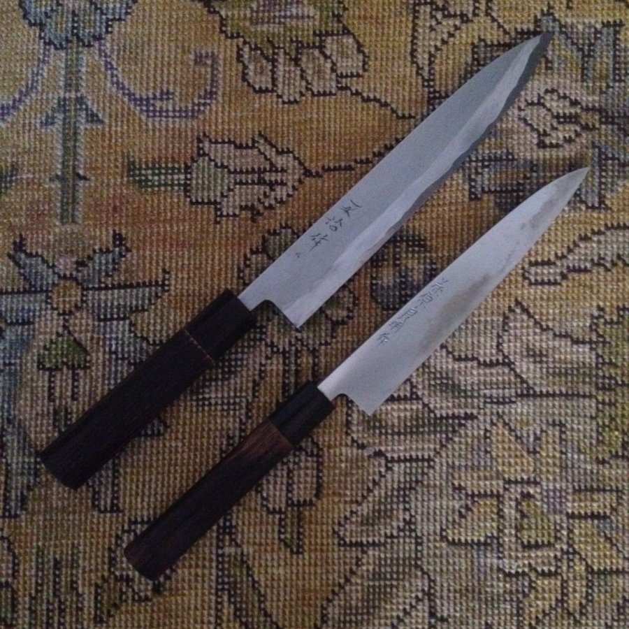

    I was just heating the very end of the tang over a stovetop gas burner for a rehandling job. I indeed did not see any color so 'we cool'.
    I was working on 2 knives of similar size, what i found interesting was how cool one stayed (heiji semi-stainless) and how hot the other (kato) got.
    I basically just laid the knife down on a magazine, placed a bag of frozen peas over the blade down to the heel, and put just the last 1/4" of the tang into the flame of a gas burner. It was cray the heiji got real cold and the kato got real hot in the same area near the heel.
    Not that this thread warrants pics, but what the hell.
    So I swapped these handles yesterday as I thought their size would be ideal on the other knife. The handle that came with my new Kato 180 was an oversized octagonal and the d-handle that came w the heiji was a good fit, but works much better on the petty.
    The only issue was the heiji took the new handle at a slight angle (the tip of the knife sweeps up) which is actually great functionally but I'm OCD so it's bothering me a little. Also my photos are awful, i know, sorry guys...
    Cheers
    Matteo
  11. Also just FYI for curious folks the dark hagane discoloring is the patina that the Heiji SS will take, it's pretty pronounced.
  12. One of my favorite things about stainless san mai is the contrast between jigane and hagane :D.
    Nice work!
  13. cris, whatever little i've done to get a compliment from you, i'll take it!
    It took about 6 attempts to get the heiji handle installed (huge tang). fortunately, my super chill 8 month old son was pretty patient while i did this.
  14. For sure my friend, lol :). I know all about working and keeping little ones occupied!
