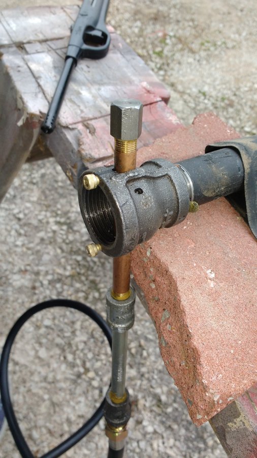

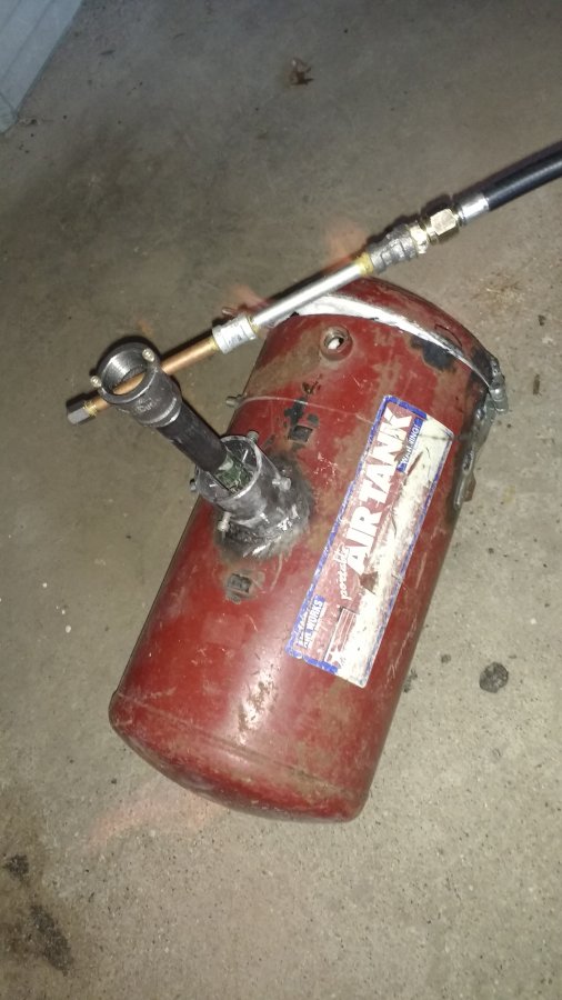

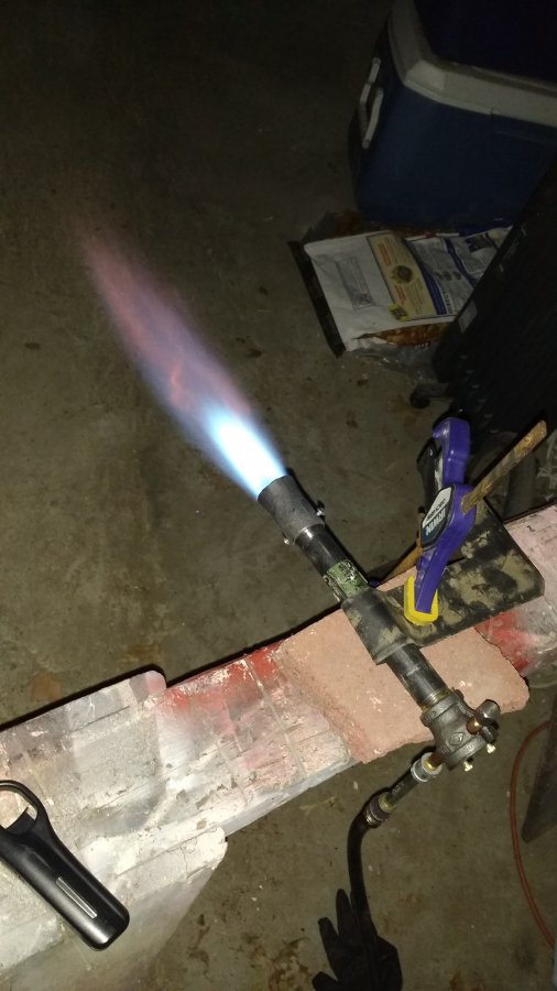

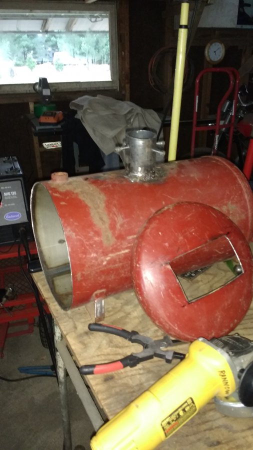

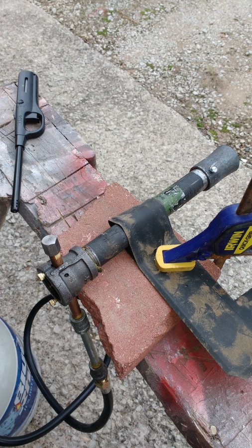

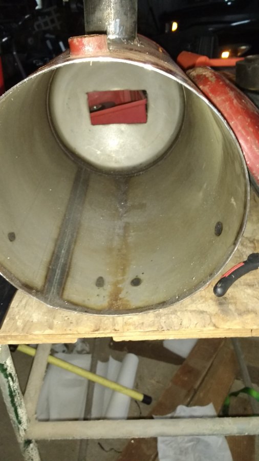

    Ha, a bit much for a smoker I think. it does throw a lot of heat. have an old portable air tank that I've begun retrofitting for the burner. got the end cut off today and holes to work through. welded a mount for the burner to the top of the tank. waiting now for the ceramic blanket, rigidizer and Satinite refractory to arrive. a conduit coupler would have been the ticket for the burner mount, but the local did not have it, so got a piece of 1.5 inch black pipe. turns out that it was probably pushing it for my mig welder. I got it on, but not proud of the welds

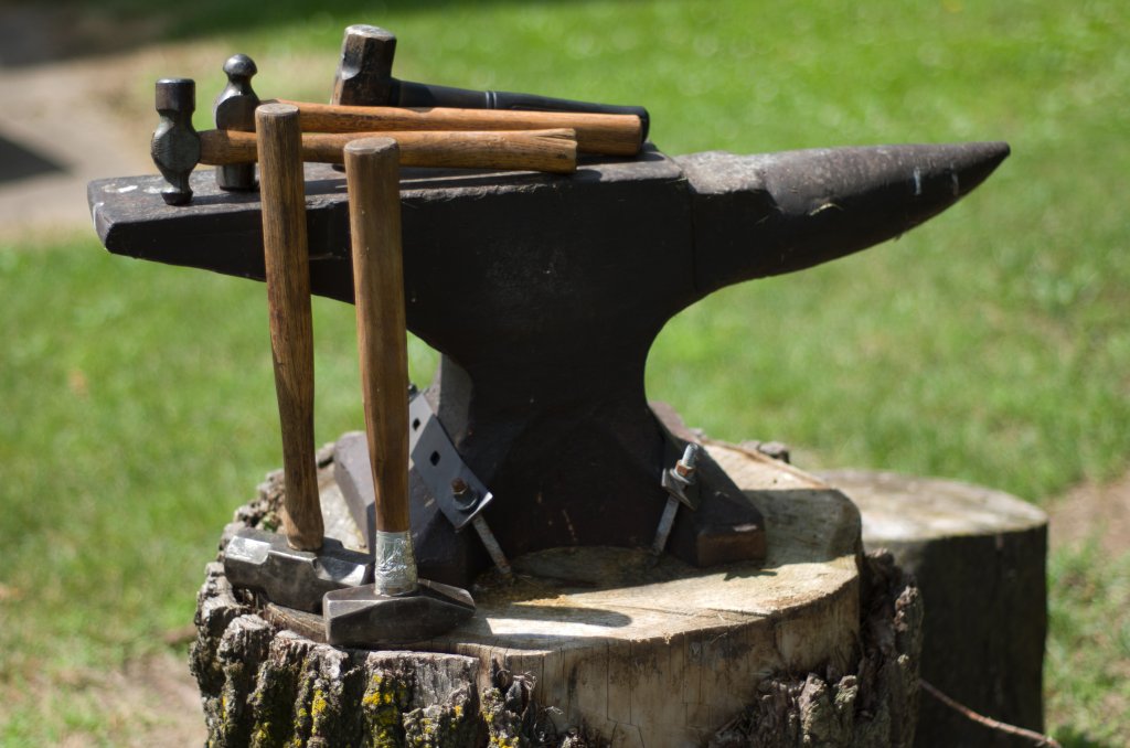

  13. MotoMike
    Not a sweet hammer, but a selection that will get me started. mjr_nov_hunt-2.jpg

  15. MotoMike

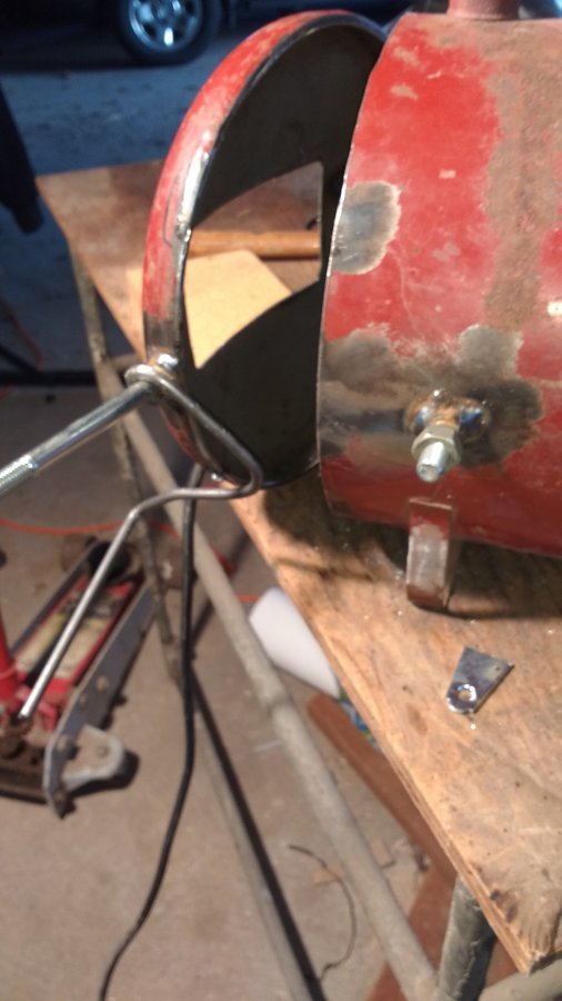

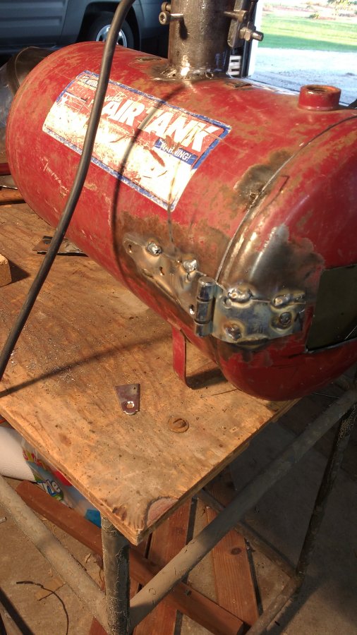

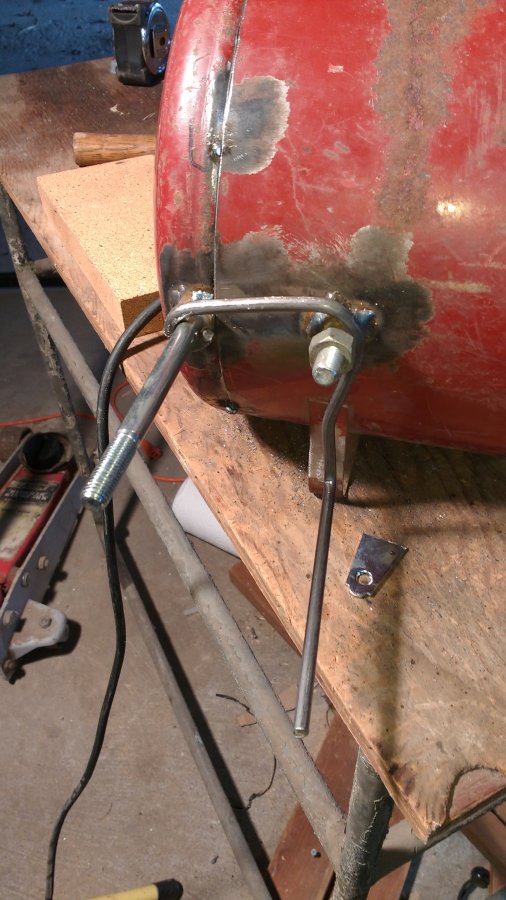

    had considered welding it together once the insulation was in. but that, I thought, would make applying the various coatings difficult, so I decided to put a hinge and latch on it. I know the welding sucks. I put a fan on me with all the doors open to move away any fumes from the galvanized and I think it pulled my gas away as well. anyway, a poor excuse is better than none. Probably fashion some handles for the latch and door.

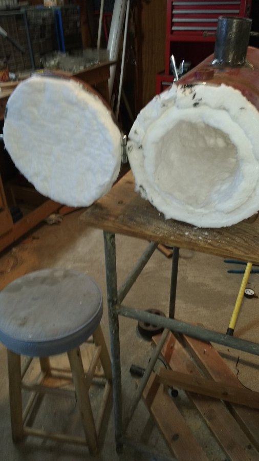

  16. MotoMike

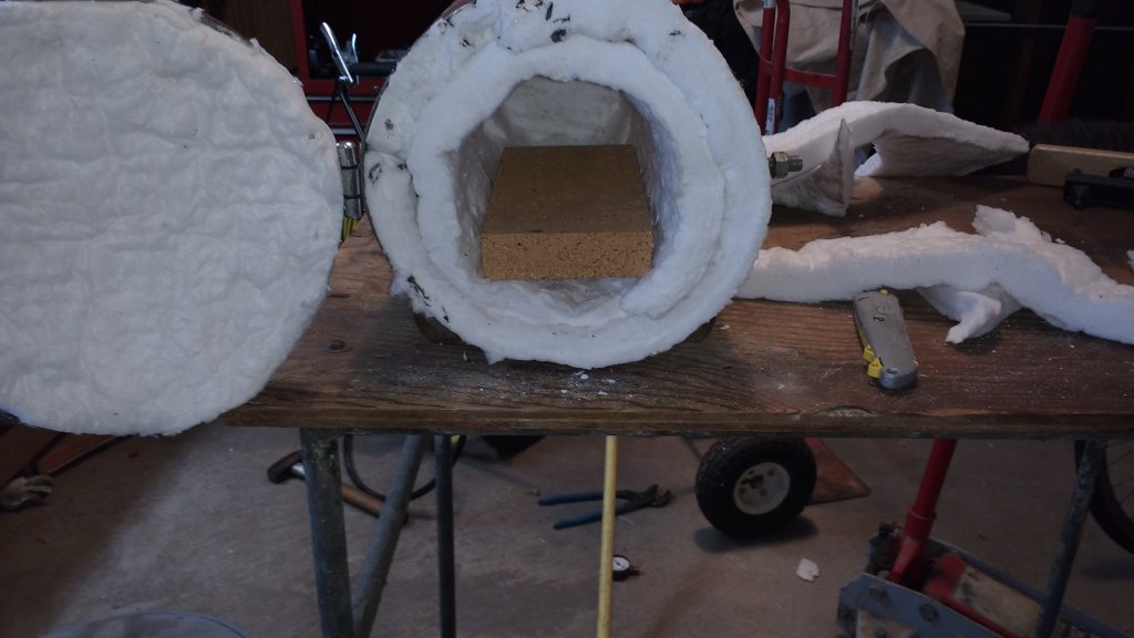

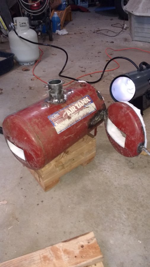

    got the insulation in it tonight. 2 layers of 1 inch koawool. coated it with colloidal silica rigidizer solution, seen being dried with my construction heater. tomorrow I will fire it to vitrify the rigidizer then apply the next coating.

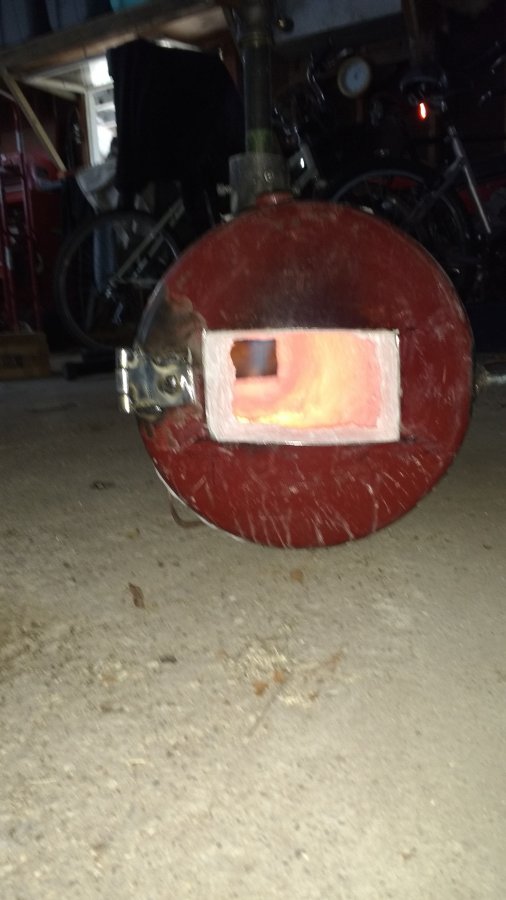

    a short burn setting the rigidizer. today I got the first coat of satinite on it. despite the flash you can see a bit of "dragon's breath" coming out of it.
