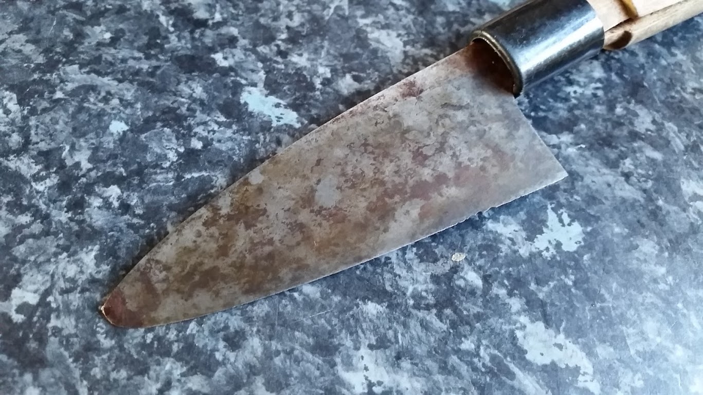

    What you gonna say for that?
  2. MotoMike
    very anxious to see what you will do Greg.
  3. BathonUk
    BathonUk Founding Member

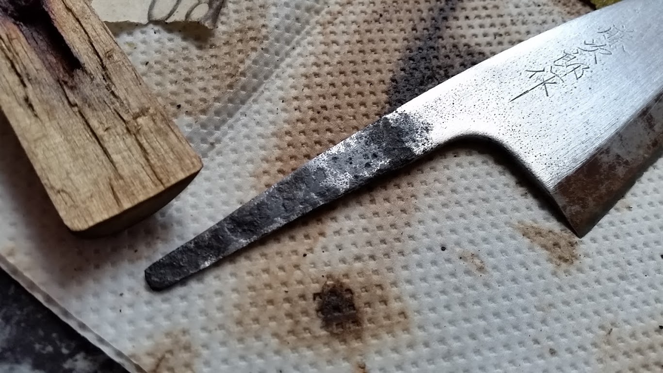

    Why do you think that I will do something about it?:D The tang is in very very bad condition:(
  4. chefcomesback
    I have an ajikiri I can send it to you Greg , I don't know where you would start with this one
  5. BathonUk

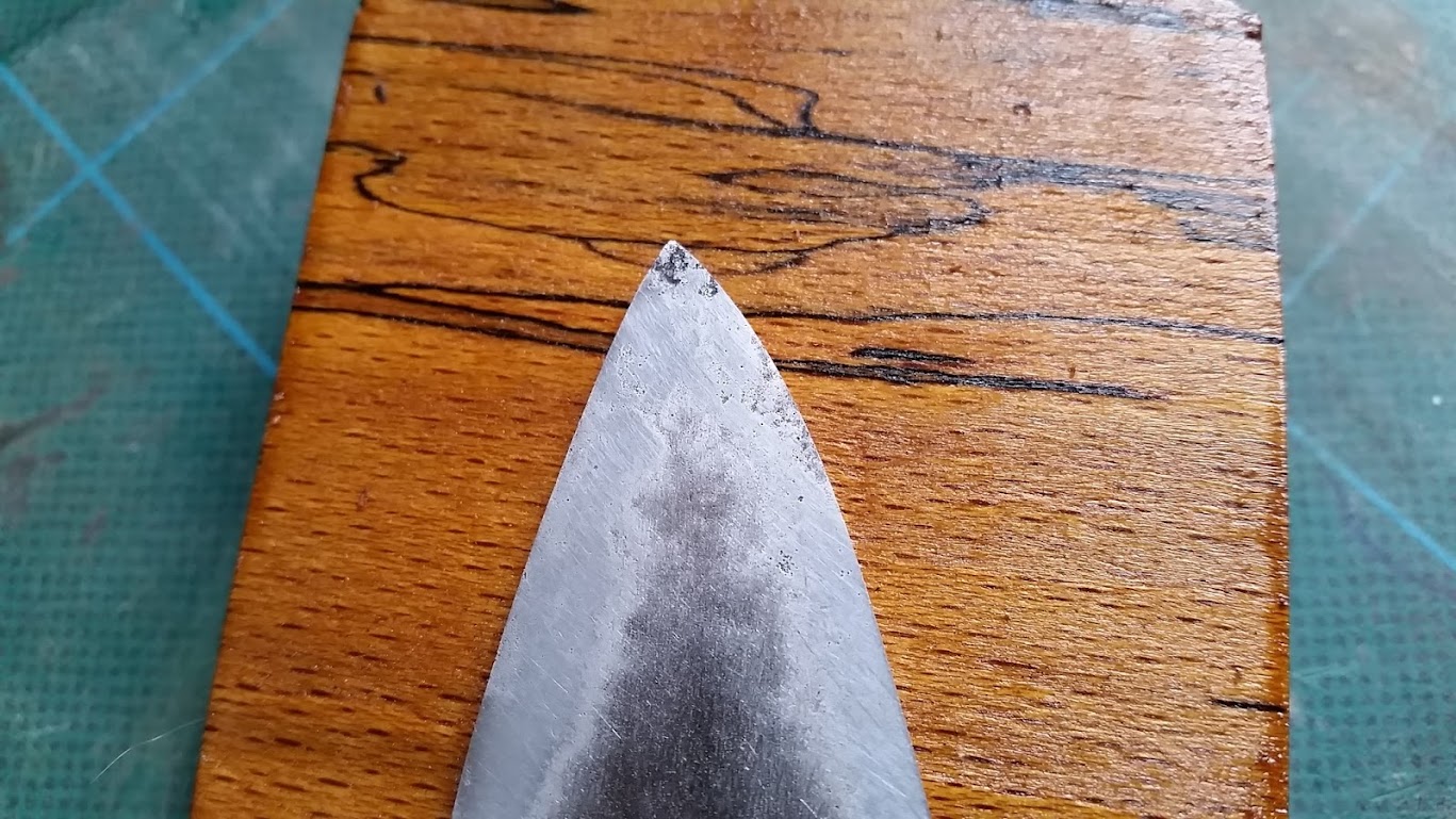

    Thank you Mert but I don't need ajikiri. I will try to bring this one to life. Somebody who ask me to fix this knife sent me a pictures, but when postman brought it today I was bewildered. Really. I will do that only because I want to check how it will turn out.
    I just clean it a little bit to check where am I standing.
    Sanding paper:
    Stones:
    Plenty of work in the future. My next step will be cleaning the tang with wire brush mounted on the drill. If I will have 2cm of clean tang then I will continue. Otherwise I will send the knife back to it's owner.
  6. Looks pretty cool so far. One quick question: why have you started cleaning bevel/polishing before fixing chips on the edge? My understanding is that edge needs significant grinding (like 2-3mm) and after such grinding you'll need to move bevel up to the same 2-3mm. Though you might have something else on your mind :)

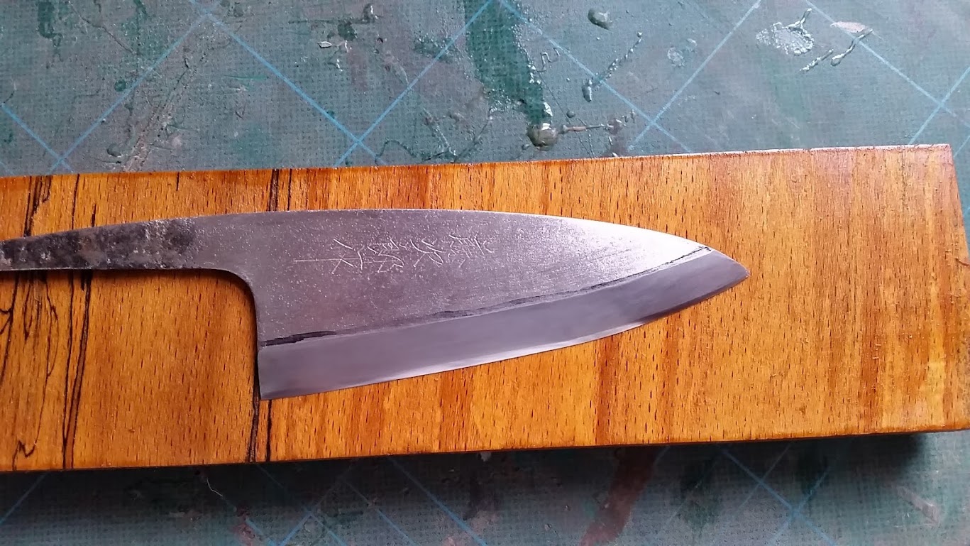

    Anton trust me, I didn't mean to work on this knife before. I had other plans but I was really curious what is happening there and is it worth to start working on it. I shouldn't even work on it today because I have hangover,after yesterdays party, but I couldn't resist.
    I cleaned tang and whole blade with dremel tool. I can't do it better. I want to leave as much tang as possible.
    [​IMG] [​IMG]
    Then I marked what I have to remove.
    I have risked using belt grinder.
    Ura side:
    And after sharpening:
    Do you think that I should work more on ura side? I am worried about these black spots and holes. If I will flatten it more then flat part will be wider. What do you think?

  12. BathonUk
    Thank you Tom for the tip and link. Actually I already talked to a friend of mine who is a carpenter and he will show me tapping out the ura side on JNS gathering.
    I finished this knife.
