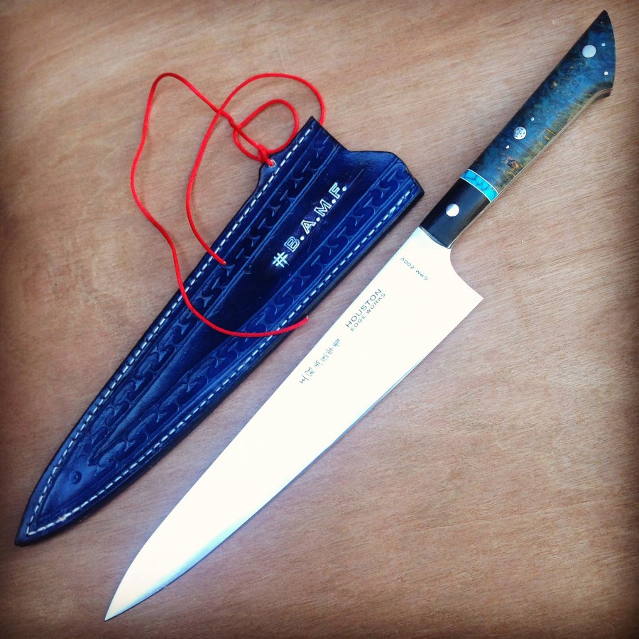

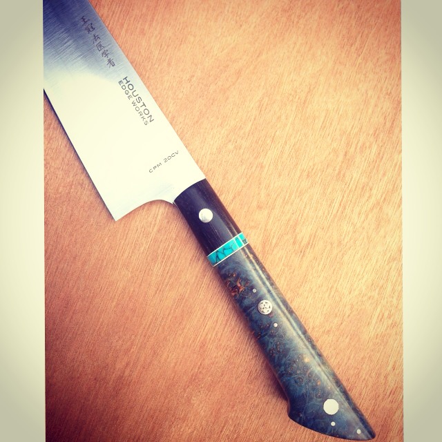

  1. 255mm CPM 20 CV super steel gyuto with blue maple Burl and ebony bolsters. Custom mosaic pins and custom fitted leather saya for a B.A.M.F. Chef.
